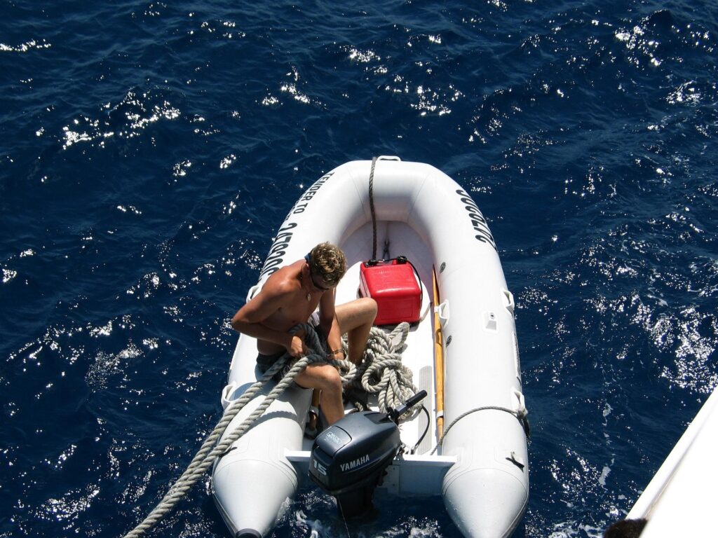

Step 1: Calculate the Total Weight
Start by identifying the total operational weight of your dinghy setup.
Include:
  • Dinghy hull (dry weight)
  • Outboard engine
  • Fuel and fluids
  • Battery and electrical components
  • Accessories and onboard equipment
Example:
  • Dinghy: 200 kg (441 lbs)
  • Outboard engine: 60 kg (132 lbs)
  • Fuel and accessories: 30 kg (66 lbs)
Total:
290 kg (639 lbs)
This total weight is the baseline for selecting the correct davit size.
