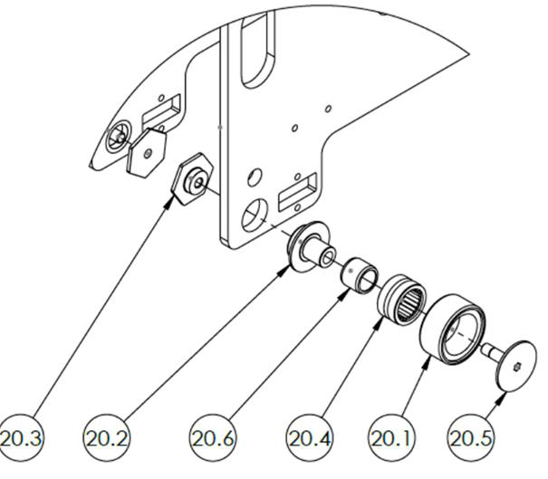

Focus on the rail system running wheels and bearings:
  • Each lifting unit includes 4 running wheels
  • Bearings must be cleaned, inspected, and re-greased
Step-by-Step Service Process
1. Remove the wheel assembly
  • Unscrew the locking bolt using a 4 mm Allen key
  • Remove the running wheel and needle bearing
2. Clean components
  • Wash with warm water and mild soap
  • Allow all parts to dry completely
3. Replace bearing (if needed)
  • Remove the old bearing using a suitable tool
  • Install the new bearing securely
  • Ensure the bearing does not rotate inside the wheel
4. Apply grease
  • Use water-resistant grease (equivalent to SKF LGMT 2/0.2)
  • Fill bearings thoroughly
5. Reassemble system
  • Reinstall all components
  • Apply grease during assembly
6. Clean the rail system
  • Use a brush and water to remove dirt
  • Ensure smooth movement of wheels
These steps ensure consistent performance and reduce mechanical wear.

Key Components in Maintenance
Important parts involved in servicing:
  • Running wheel (rail system)
  • Needle bearings (items 20.4 & 20.6)
  • Bushings (maintenance items)
These components are subject to wear and should be inspected regularly.
